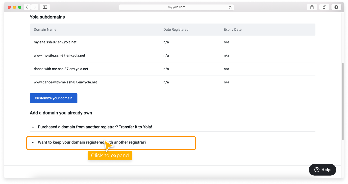

  1. In the My Yola dashboard, click Domains on the Topbar.
  2. Scroll down and expand the Want to keep your domain registered with another registrar? section.

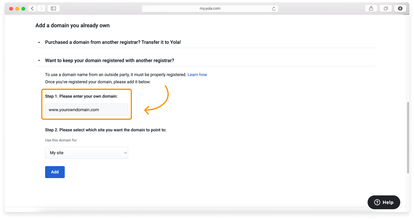

  3. Type your domain name in the Domain field. You can enter either www or bare domain here. The entered value will become the primary domain, for example,  the website will open with https://www.mydomain.com or with https://mydomain.com in the address bar.

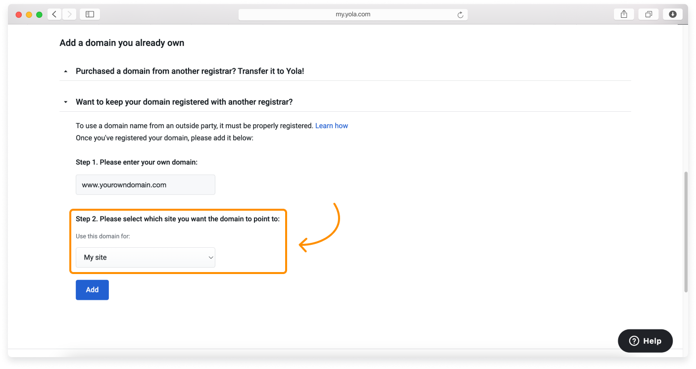

  4. Select the site you want to use with this domain from the dropdown list.
  5. Click Add.

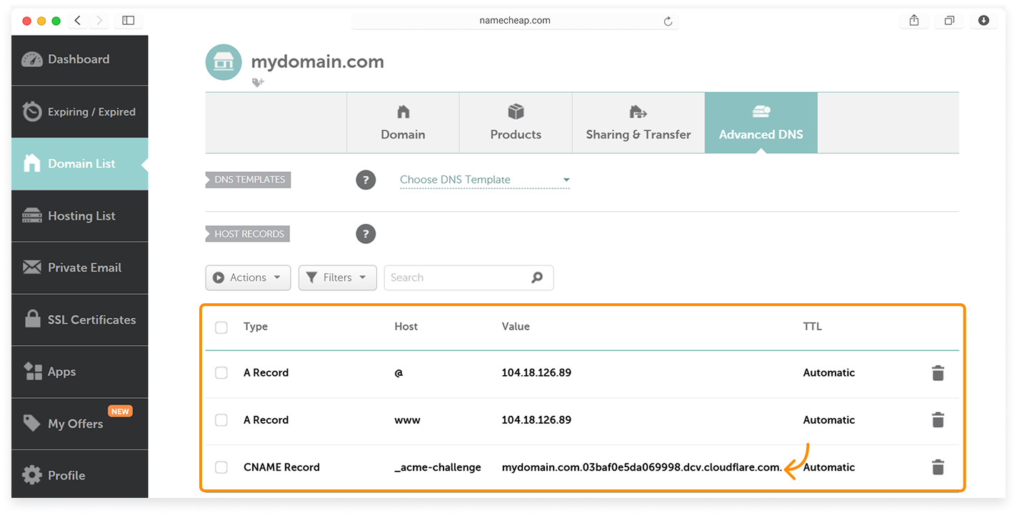

Step 3, with a list of DNS records to point your domain, will appear after you've clicked Add at the end of the previous stage. Now, go to your domain's DNS management area on your provider's side and add all of the records from the provided list. See the example records below.
A record for mydomain.com domain:
  • Name: @ or mydomain.com
  • Value: 104.18.126.89
A record for your www.mydomain.com domain:
  • Name: www or www.mydomain.com
CNAME record:
  • Name: _acme-challenge or _acme-challenge.mydomain.com
  • Value:​​  mydomain.com.03baf0e5da069998.dcv.cloudflare.com (Try setting the record with the trailing dot at the end if your registrar shows an error.)
Each domain provider has different requirements when it comes to adding DNS records. For instance, with some providers, you may need only www as the A record’s Name, while others require your domain name with www appended, e.g., www.mydomain.com. We strongly recommend checking your provider’s requirements or contacting them directly for advice before adding DNS records. As an example, take a look at the records in one of the domain registrars:
Note: When adding the records, replace mydomain.com with your actual domain name.

  1. Log in to your Yola account and navigate to the My Yola dashboard.
  2. Click Domains on the Topbar.
  3. Scroll down and expand the Want to keep your domain registered with another registrar? section.
  4. Enter shop.mydomain.com in the Domain field.
  5. From the Use this domain for dropdown, select the site you want to connect the subdomain to.
  6. Click Add.

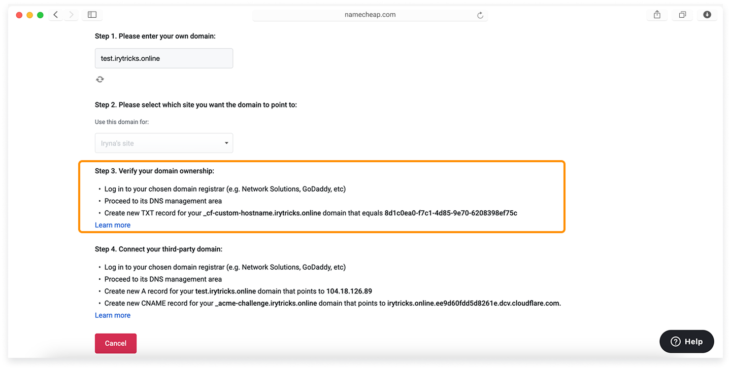

Stage 2: Verify your domain ownership
  1. Log into your domain provider’s account.
  2. Access the DNS management area of your domain.
  3. Create a new TXT record:
    • Name:  _cf-custom-hostname or _cf-custom-hostname.mydomain.com
    • Value:  The value is unique for each domain. Please copy the value from Step 3 in My Yola.
  4. Save the changes.

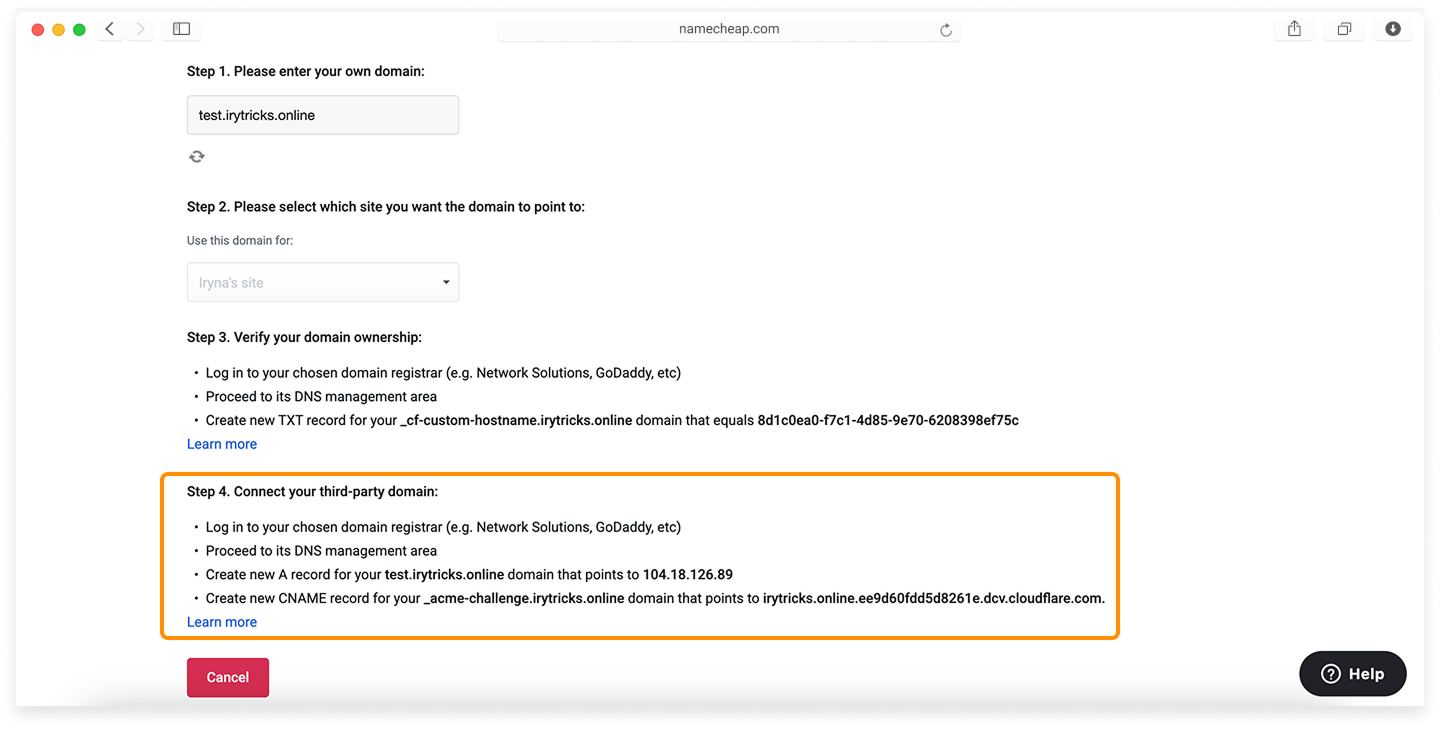

Stage 3: Add A and CNAME records
After you save the changes at Stage 2, Step 4, with a list of DNS records to point your subdomain, will appear. Now, go to your domain's DNS management area on your provider's side and again add all of the records from the provided list. See the example records below:
  • A record:
    • Name: shop or shop.mydomain.com
  • CNAME record:
    • Value: mydomain.com.03baf0e5da069998.dcv.cloudflare.com (Try setting the record with the trailing dot at the end if your registrar shows an error.)
Save the records and check whether the pointing was successful in My Yola. If the green checkmark appears, the pointing is successful.

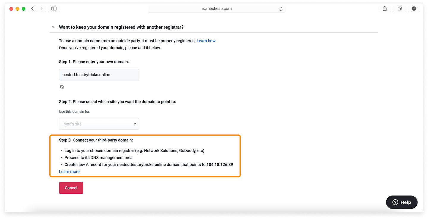

Pointing 2+ level subdomain
For subdomains with two or more levels (such as shop.qa.mydomain.com), follow these steps to configure and connect the domain to Yola:
Stage 1: Connect the subdomain to your Yola site
  4. Enter shop.qa.mydomain.com in the Domain field.
  6. Click Add.
Stage 2: Add A record for the subdomain
  1. Log in to your domain registrar’s account.
  2. Access the DNS management area.
  3. Create the following A record:
    • Name: shop.qa.mydomain.com
Note: Ensure you’ve replaced shop.qa.mydomain.com with your own 2+ level subdomain name.
Please allow time for DNS propagation (up to 48 hours, but usually less). If the connection does not succeed within 5-10 minutes, contact Yola’s customer support for guidance.
